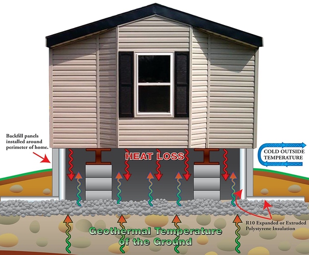

  2. Here is image of a frost protected shallow foundation for MH
Concrete piers are the most cost effective and we have cement poured for about $1100 for a 16x80. Remember that we drill all the holes and do the rest.
Basewall may cost us $3-4 and helical piles about $6-8k. Concrete slabs are the one type we do not do at our community (ie we do not do the work. Homeowners can pay for this at their cost).
