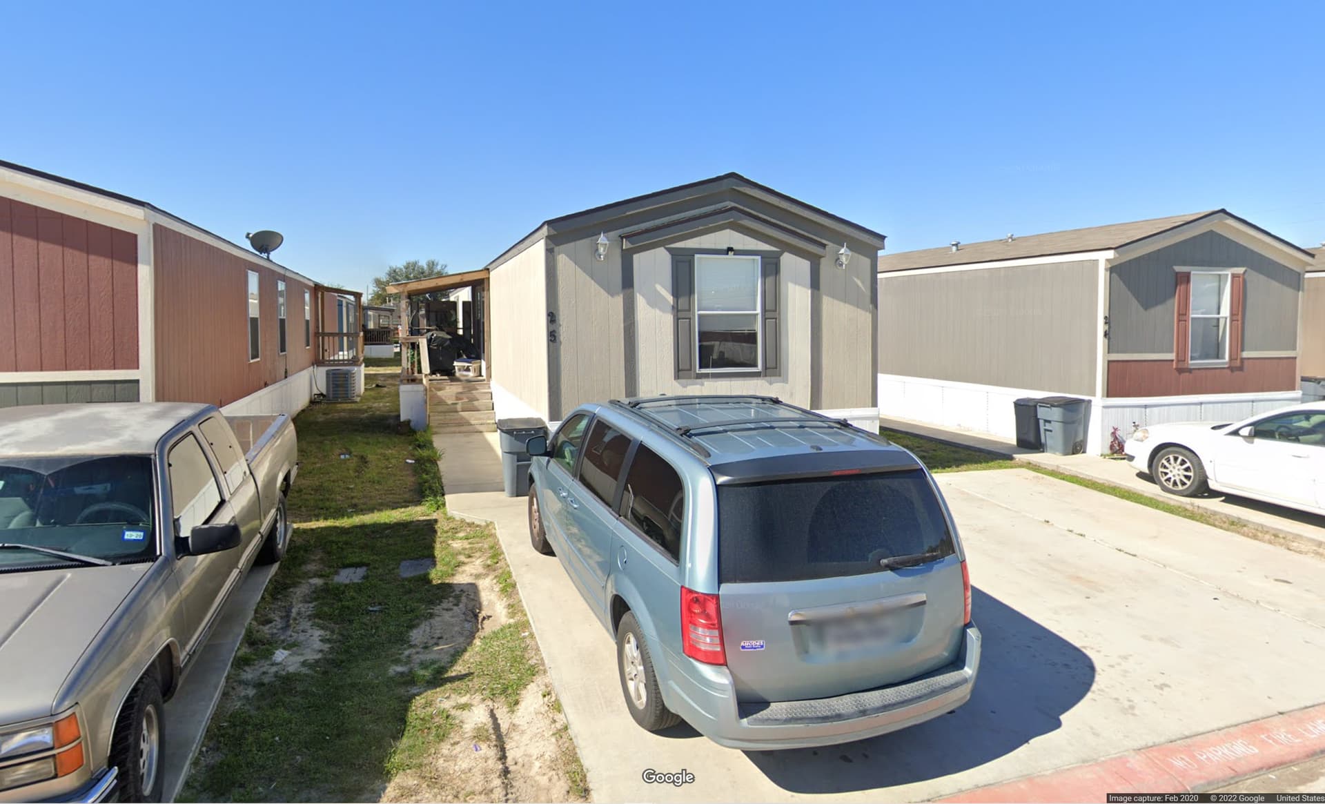

I have spoken to a few people in the industry and a few developers 40ft seems to be the norm. Evidently each market it different, I came across this project which has 30ft lots with a small patio. I believe in the high demand/ high barriers to entry markets people will go lower than 40 ft, just need to find the sweet spot.

That setup doesn’t look to bad tho. I imagine neighbor noise complaints and general tenant conflict would be higher in a tight park like that, compared to a park with more space. Parking can be an issue also, some people will want visitor parking or the chance to have a 3rd vehicle parked on site. Something to think about.

It is unfortunate that developers are essentially providing a concrete parking lot for home owners to live in. Doubtful it is a enjoyable living environment. Majority of home owners likely spend all their time inside the home. Scary to think what the effect of a house fire would be.
