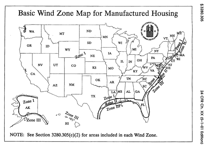

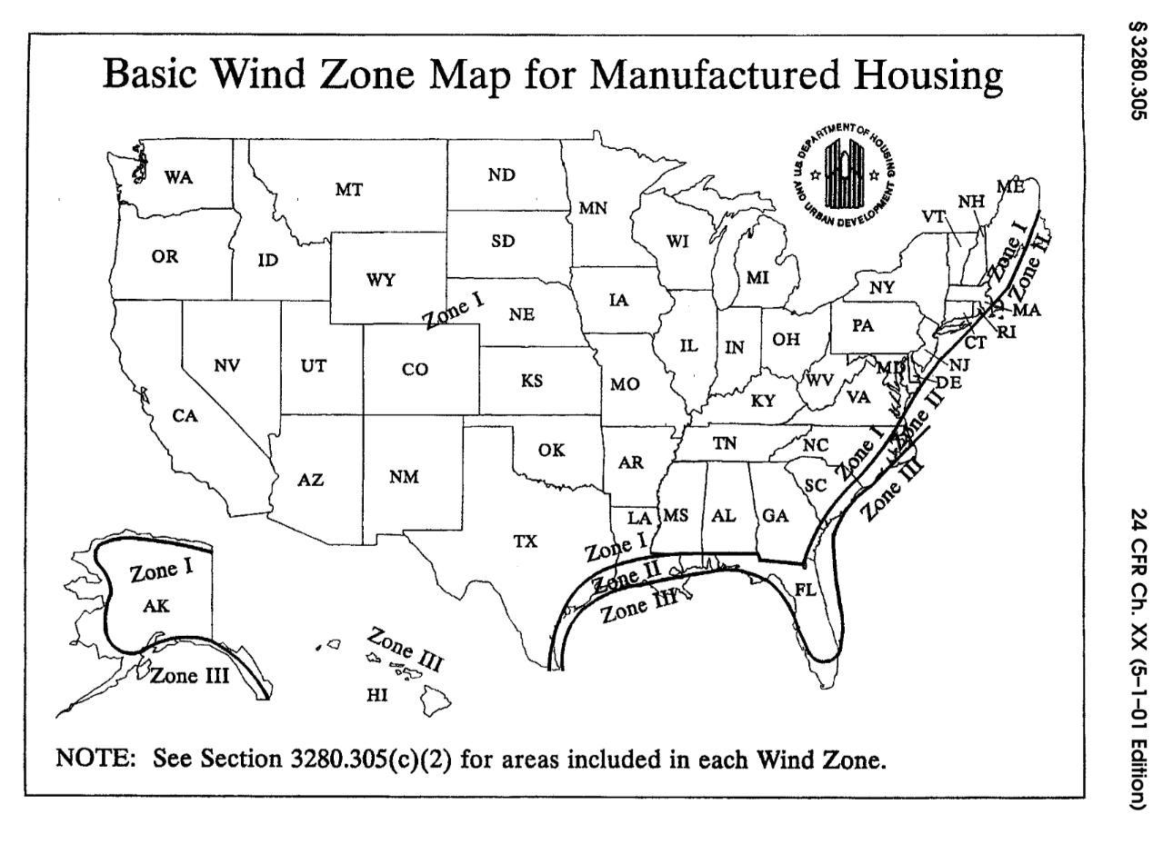

BTW, here is the same for wind:
You should ask your local MHA in what wind and snow zone your park is. Then you can check your VINs to make sure your homes are appropriate for your zone. If so, I’d not bother with removing snow, unless you get snow of Biblical proportions.
