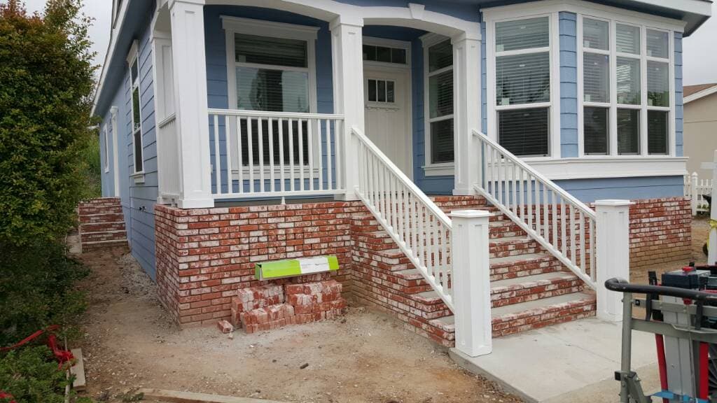

If the budget allows, we will install a cement board as a base on the front of the home and make a brick veneer.

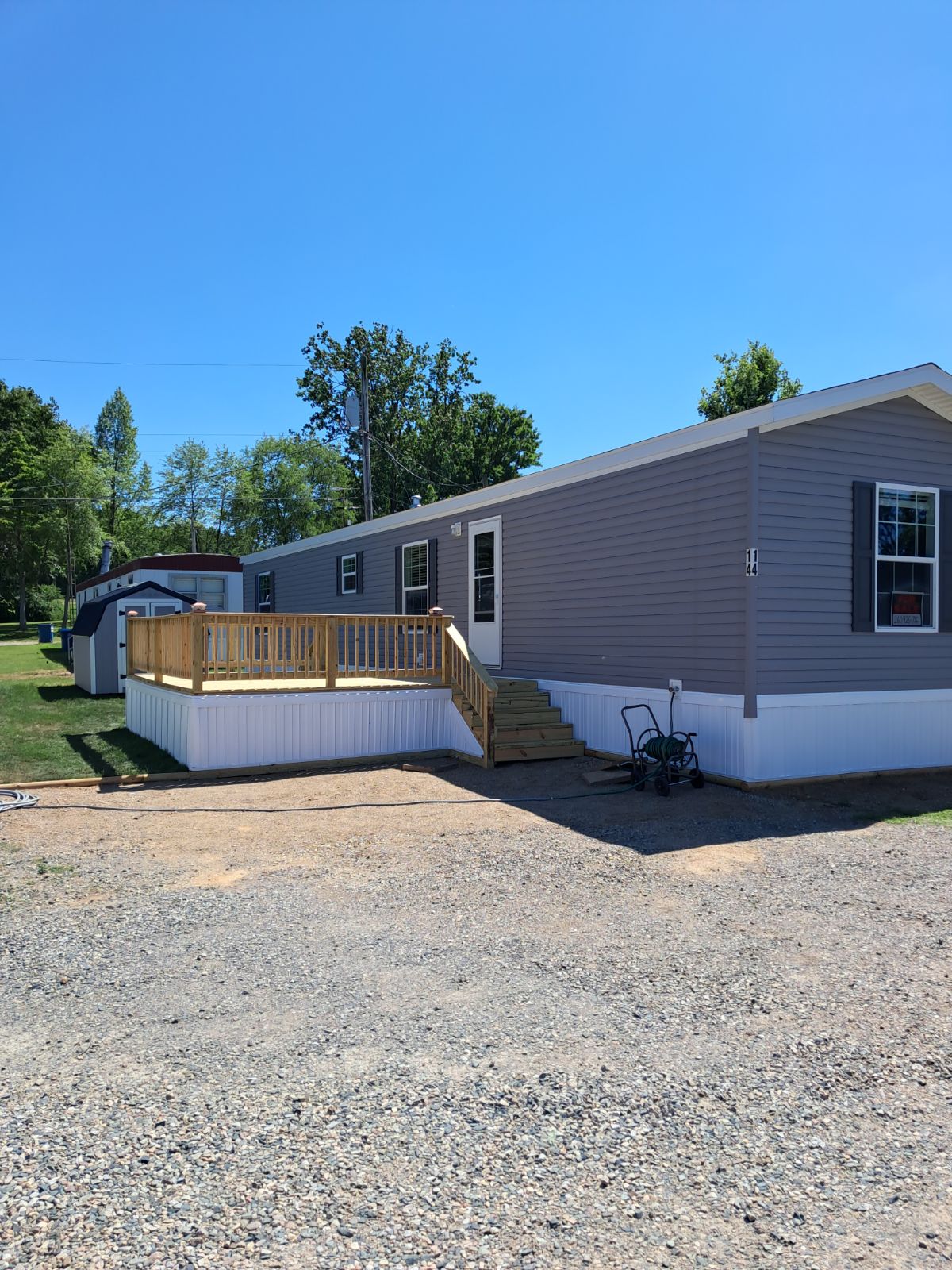

This is not one of my homes, but this is an excellent example of the look we are going for.

hey @mobilehomepark what size deck it that? it looks great

I think it is roughly 12x14. I cannot remember exactly. We ended up putting up a roof overhang over the deck which is not in the pic. That makes the deck like an extra living space for the tenants. They can sit out on the deck rain or shine.
