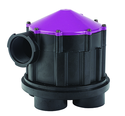

I suggest you stay away from the “automatic” switchers. Having your maintenance staff go out to the leach field and swap the lines around as needed is very easy. The automatic valves are great, but you add one more opportunity for an electronic failure.
