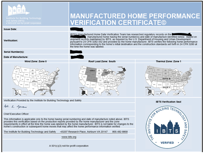

Below is an IBTS “Manufactured Home Performance Verification Certificate” which states Wind Zone & Roof Load Zone & Thermal Zone for a specific Mobile Home.
We use the IBTS “Manufactured Home Performance Verification Certificate” or HUD Compliance Certificate (placed in Mobile Home by Manufacturer) as proof to verify to the City that our newly moved & setup Mobile Home meets the “Wind Zone” for our area.
The Maps on the IBTS “Manufactured Home Performance Verification Certificate” show what areas need upgraded Wind Zone & Roof Load Zone & Thermal Zone.
However, I would verify that these Maps are up-to-date (as this IBTS “Manufactured Home Performance Verification Certificate” was for an 80’s Mobile Home).
