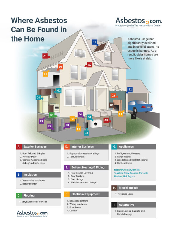

Typically, you will find asbestos in a few areas. One is in the floor tiles; if they are 9", then they likely have it. It can also be located in the ceiling tiles. The other spot is in the Window sealant.

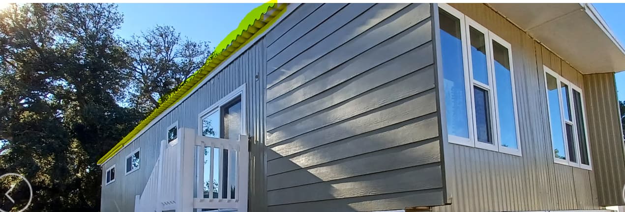

I have one unit with a AC style retrofit roof. 100% that has asbestos in it. I highlighted the AC roof material.
Remediation cost varies by geographic location and the quantity of contamination.
If it is just in the window sealant, then the remediation company will cut out the window and use a 4-6" margin around the window so as not to disturb the sealant.
If it’s in the floor or ceiling, that gets expensive.
I have demoed quite a few, and I have only found Asbestos in one unit. It was the sealant in the windows; they just cut out the window with a bigger hole, bagged the windows, and sent them to the asbestos dump.
