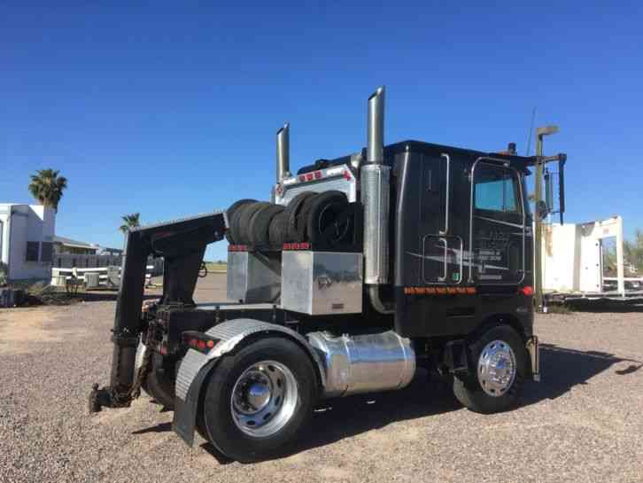

The coolest Toter I ever saw had a fully articulating Hitch. I think it was called an Omni Hitch.
It’s basically a fully articulating hydraulic arm that can reach out and hook up.
He even had a Fifth Wheel adapter for moving RV’s.
This guy could put a Single Wide into the Tightest Spot ever. He NEVER had to unhook and reposition. I used him for +20 years.
It was definitely the best set up, unless you want to bring along a House Tug.

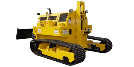

You HAVE TO HAVE a house tug, platypus, and two RELIABLE trucks that can haul them, block, and axles. There are a lot of old guys out here using bottle jacks and their trucks and that’s it. That’s how it’s been done since the beginning of time but it’s significantly more dangerous and time consuming. The reason you NEED this equipment is to work year round, or as close to it as possible. Most guys with just a truck and bottle jacks shut down from Oct/Nov until March or April because it’s too wet to work. If your truck has no traction and the house in sinking in the mud you just have to pack up and go home.
Buy your house tug and platypus from Cutting Systems Inc (CSI) in Union Grove, NC. They’re known across the country for building the best machines and they stand behind their work. DO NOT buy Remote Trax. Their machine is garbage. I know other setup guys in my area that have had their CSI house tug for 30 years; I’m not exaggerating.

House Tug and Platypus: $132,000

IF you want to start cheaper and use a truck and bottle jacks then go for it. A decent toter is $30-40k. Make sure it has a 6-way hitch. Buy a single axle, not tandem; easier to maneuver since you’re going to be working in tight spaces at times.

BTW, if you can manage to get a jadde 2000. I can show you how to put it on in 30 minutes and it is much easier and safer to use than a translift or platypus, and will make impossible moves seem easy.
