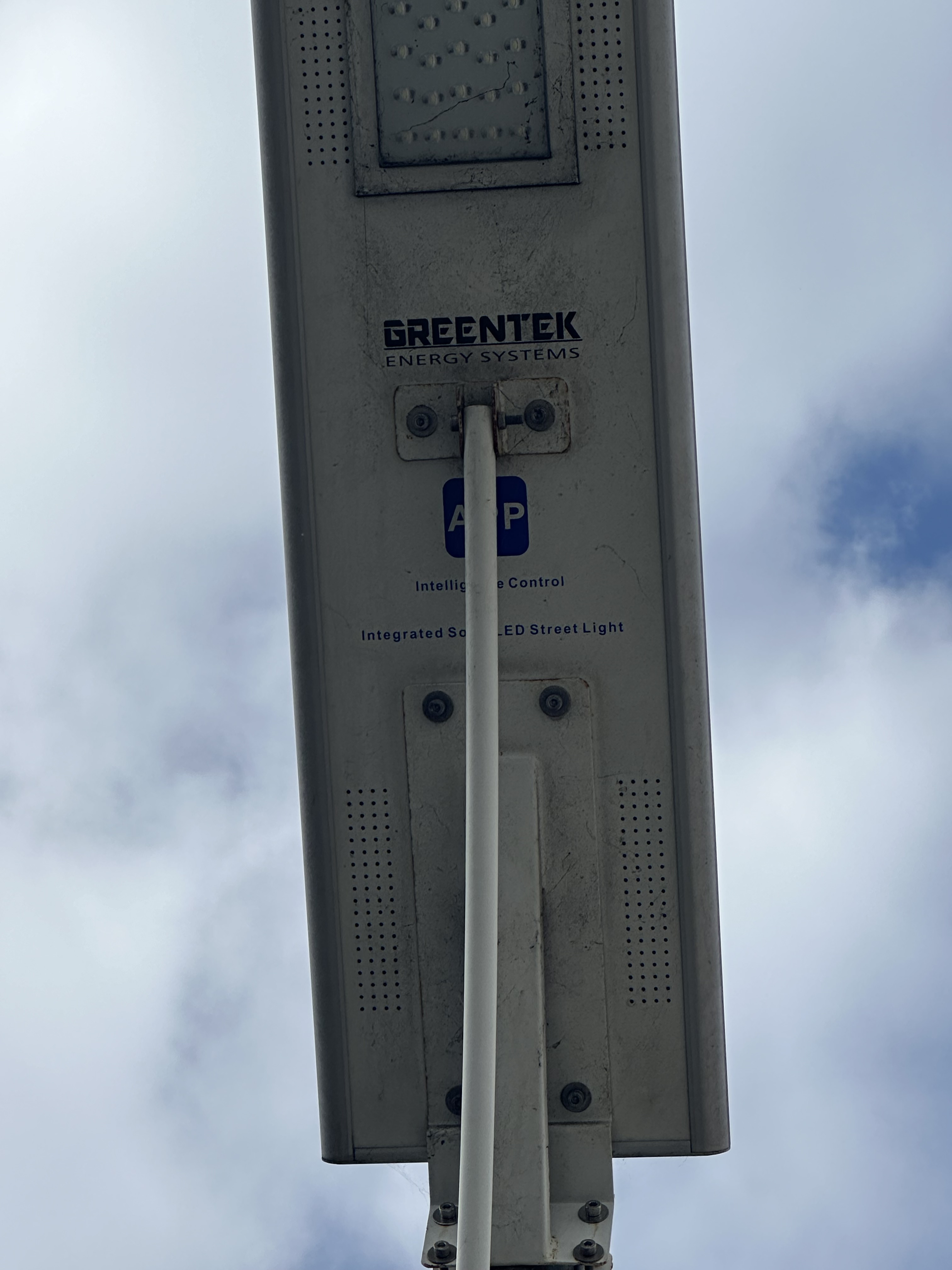

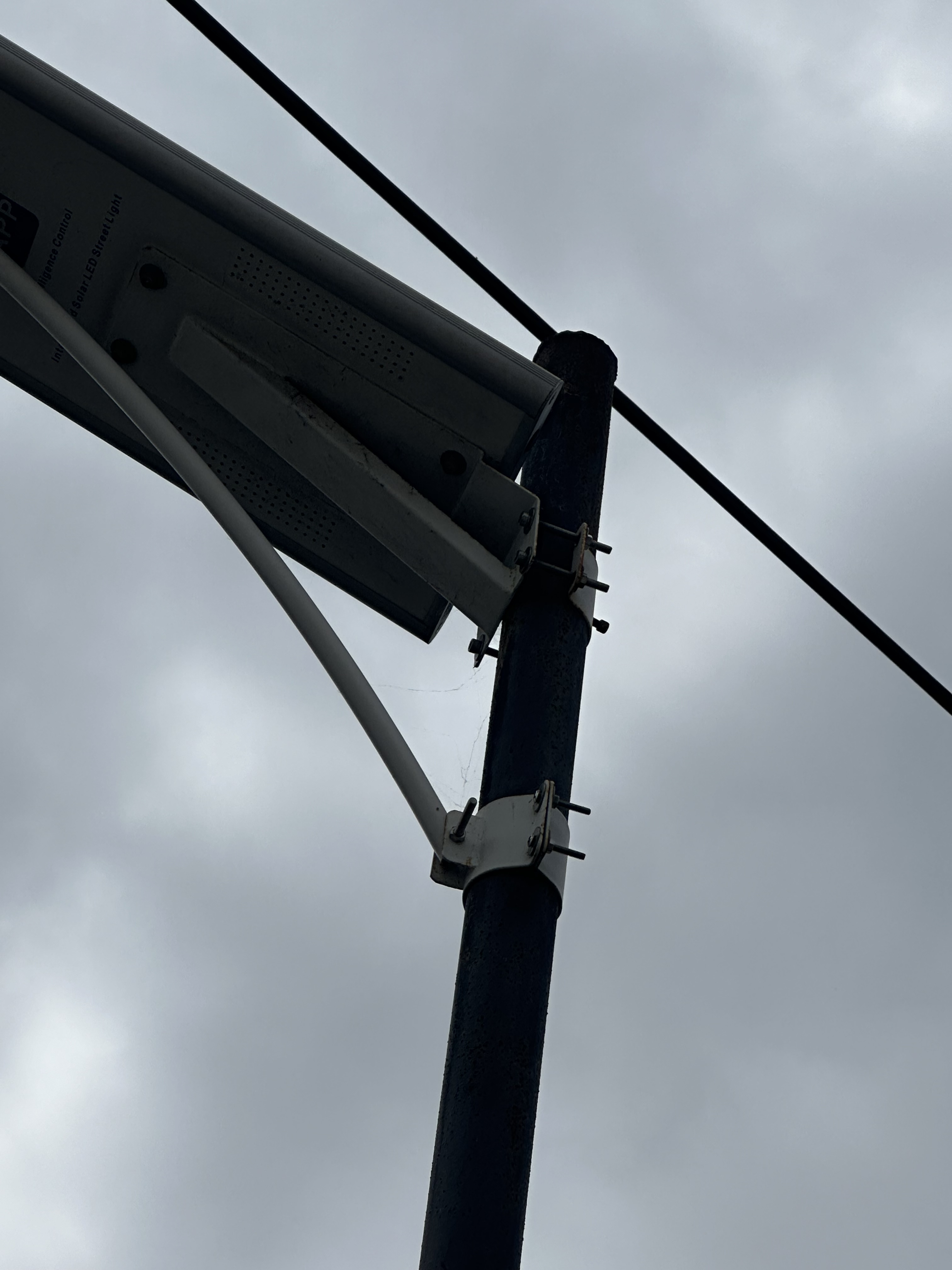

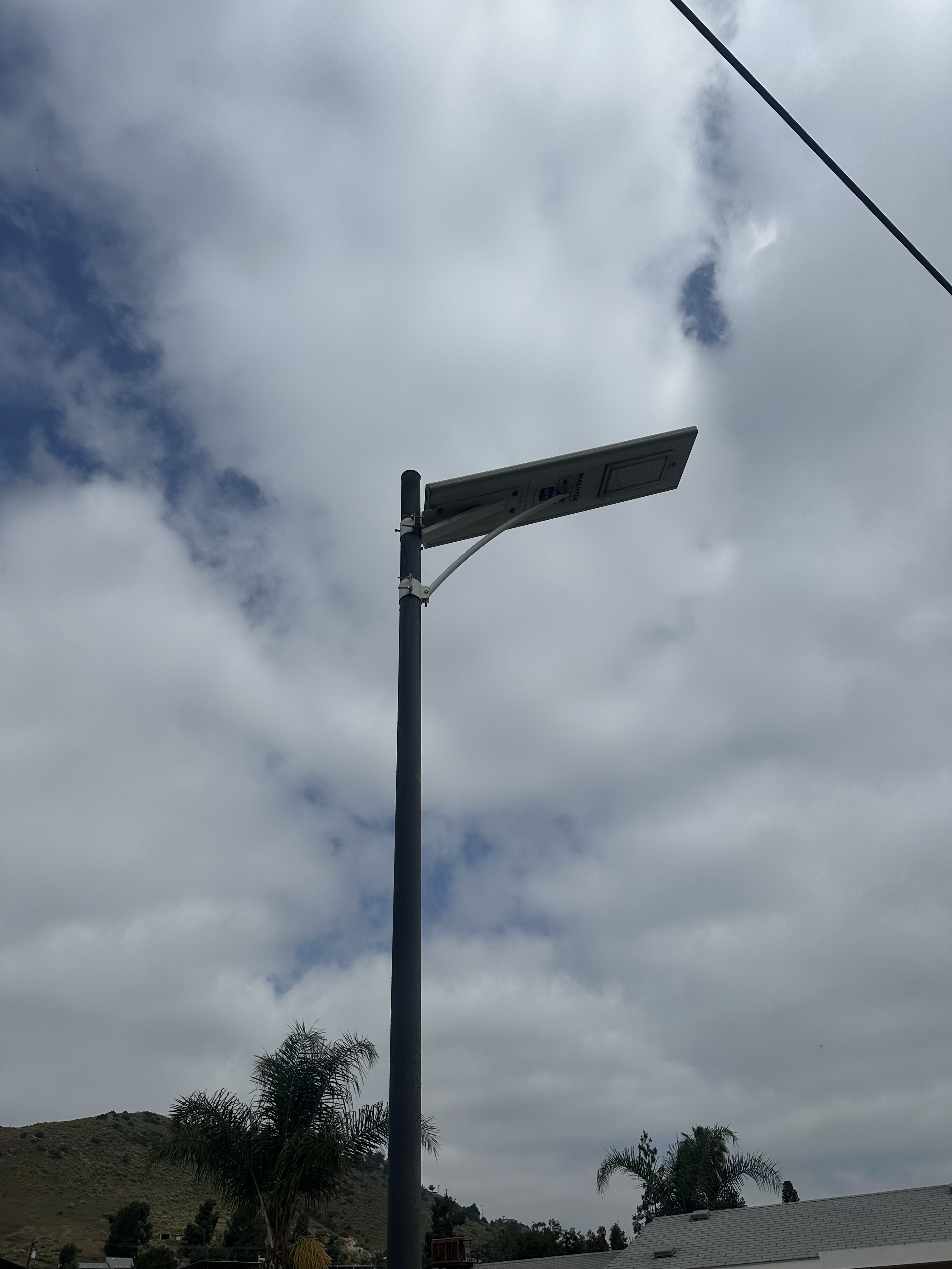

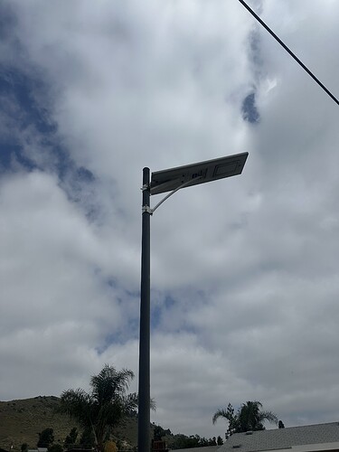

Here are the lights we used. We just retro fit the old light system with the LED lights.
You guys find the light sufficient? Spacing between the poles?
No complaints from the residents.
The light locations were approved when the park was built. There are one or two lights on each row of homes.
What is your state and how did you pick this specific model. Trying to see what model will work for us.
We are in CA.
This model suited our needs.

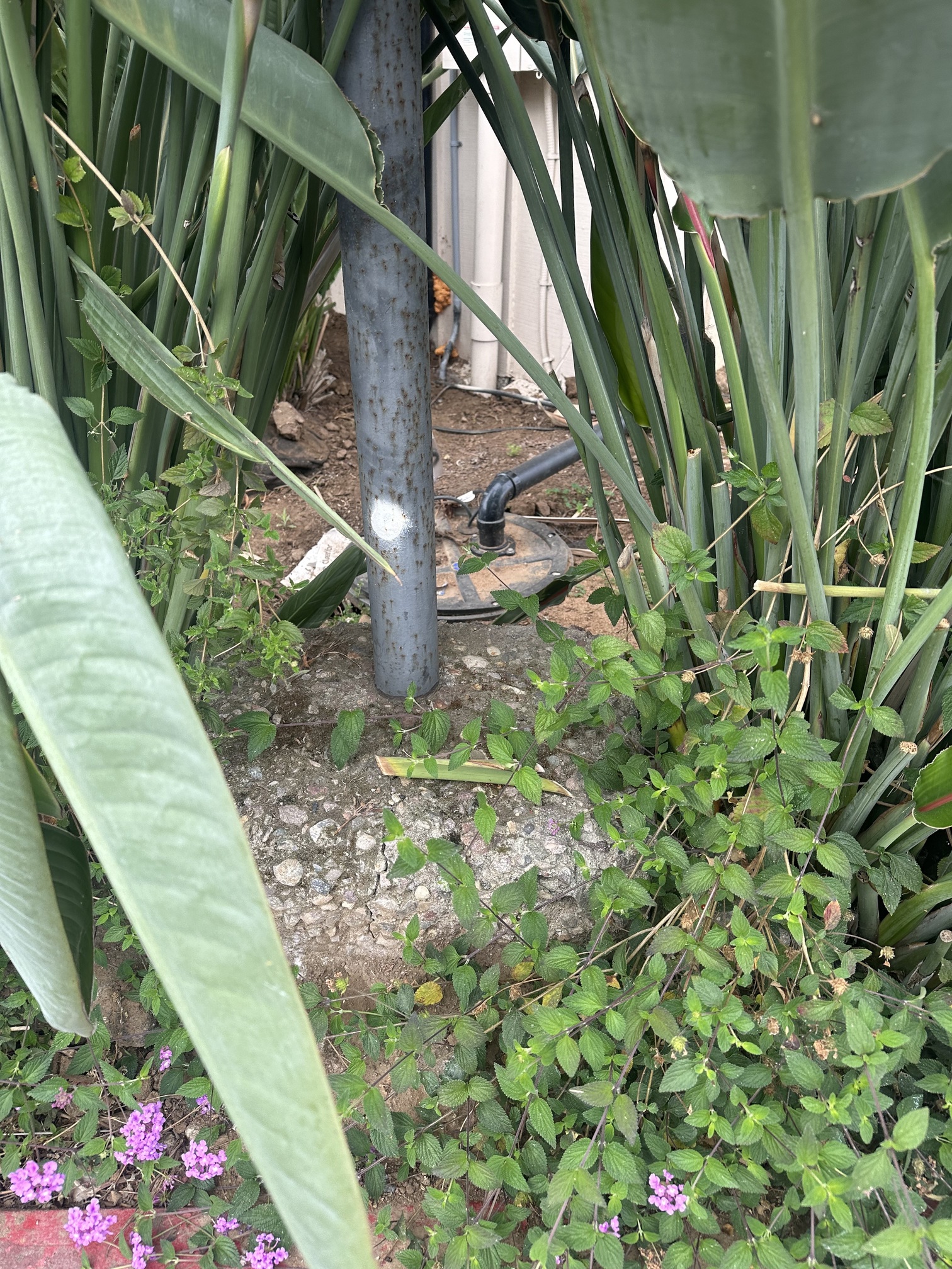

How high are your poles off the ground? Did the source the poles locally and cement them in one piece into the ground ?
I did not measure them, but I estimate 15-20’
Some poles were from the legacy lighting system, and some were new. I suggest Schedule 40 Galvanized Poles 3" or larger.
You can use a Quick Tube to concrete them. It would be best to dig a footer at least 2’x2’x2’ so the pole doesn’t fall over. If you have frost in your area, you should check with your local building inspector for the proper depth and size of a footer. You may need a permit.
