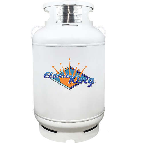

Then go get yourself a large propane tank.
Propane lasts forever. Gas will degrade. Also, most portable generators only hold about 4-6 hours’ worth of fuel. If you use a 50-gallon propane tank, it will last days! Also, in most parts of the country, you do not need a permit for a 50-gallon propane tank. Just check with your local building department.
Also, with a 50-gallon tank, you can order additional propane delivery if needed.
