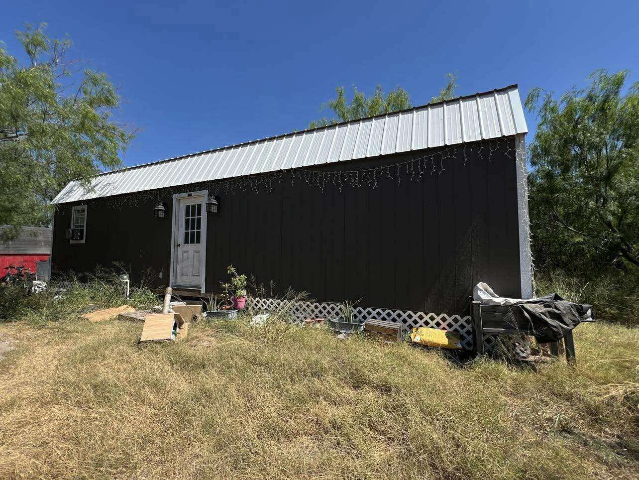

That does not look to be a “tiny home.” It looks like a shed or garage with a window. Unless it was professionally built (e.g. has a HUD Code sticker or the equivalent for a road-ready DOT registered RV), I would stay away. It also looks horrible, and will degrade a property with its appearance.
YIKES!
How will anyone connect water / sewer and service those utility connections?
What housing code did they follow in the build? HUD? Probably none.
How’s it to be insured by tenant to protect you from liability?
How is it to be tied down to meet code?
