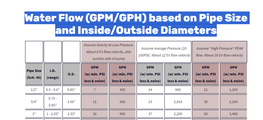

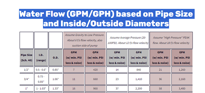

In due diligence we found 4 major leaks under homes and several dripping faucets and 1 slowly running toilet. I can’t tell if this is enough for the water usage to triple. So for 22 occupied units we found:
3 garden hose size leaks running 24/7
1 leak spraying water under the house but less than a garden hose
1 slowly running toilet not flushing full speed but you could hear a slow continual drain and
4-5 constantly dripping faucets
Does anyone think I need to call a leak detection specialist or do I close, fix all this and then look at the water bill?
Three garden hoses running 24/7 is a MAJOR leak.
Each hose 3/4 leak is sending approximately 1000 Gallons/Hour.
3,000 GPH x 24hours x 30 days
2.1MM Gallons per month.
I am assuming about 60 psi for your Park.
